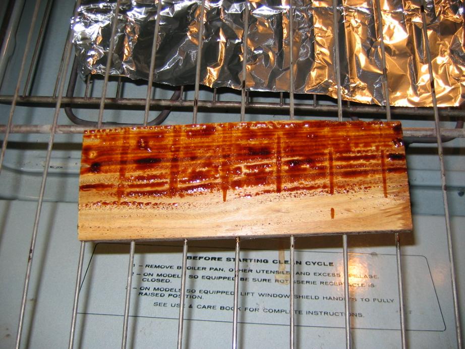

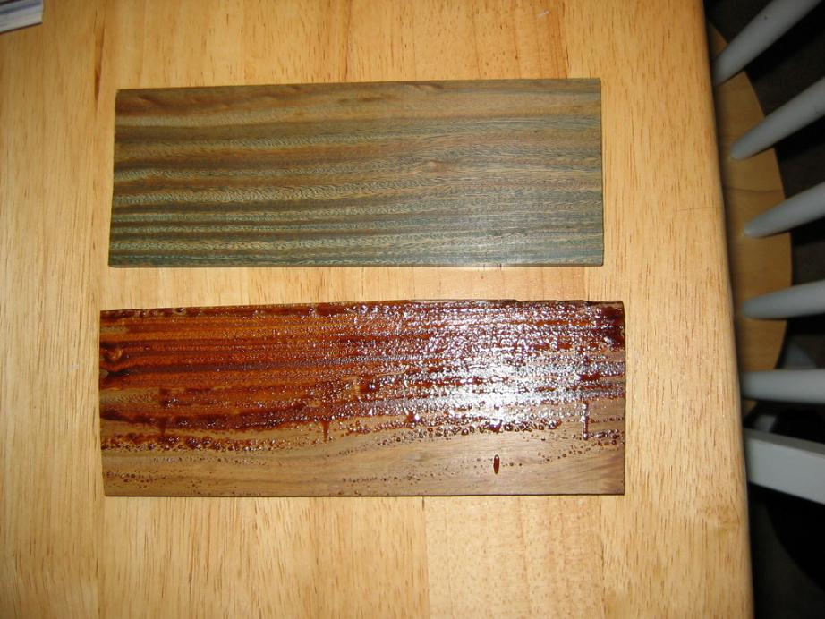

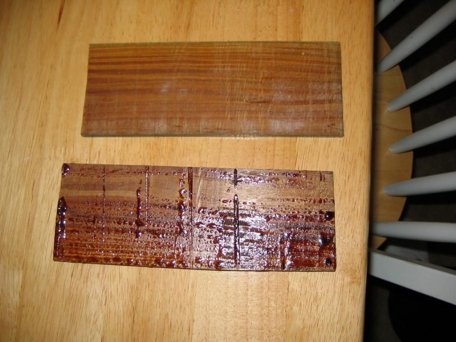

I've never baking anything beside food and the occasional car part before (don't ask), so could someone tell me if this amount resin seepage is normal?
200F for about 1.5-2 hours
Compared to what it did look like
This stuff dries on hard. Resin rock candy.

Wow! My spruce had a bunch of speckled spots on it that sanded straight out, but that is nutz.
Lots of goop left in that one, for sure. Is it scrape-able when its oozing?

I thought about trying to wipe it off occasionally but I didn't want to "rub it in." I thought if I let it collect on the suface it might pop off easier when I try to scrape it. I also didn't want to get it on my hands. I said rock candy before and it reminded me of a time I stuck my finger in a batch of molten candy. Ouch. It's like when you eat a pizza that is too hot and the cheese gets stuck to the roof of your mouth and just burns and burns...
